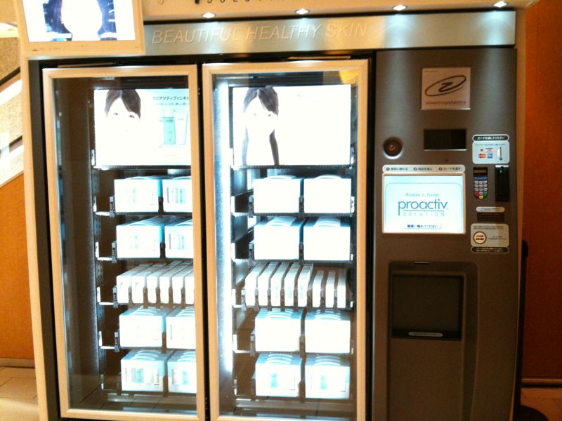

![[http://www.amazingincredible.com/pictures/58-1.jpg ]](http://www.amazingincredible.com/pictures/58-1.jpg)
Nebo třeba jiné automaty...
