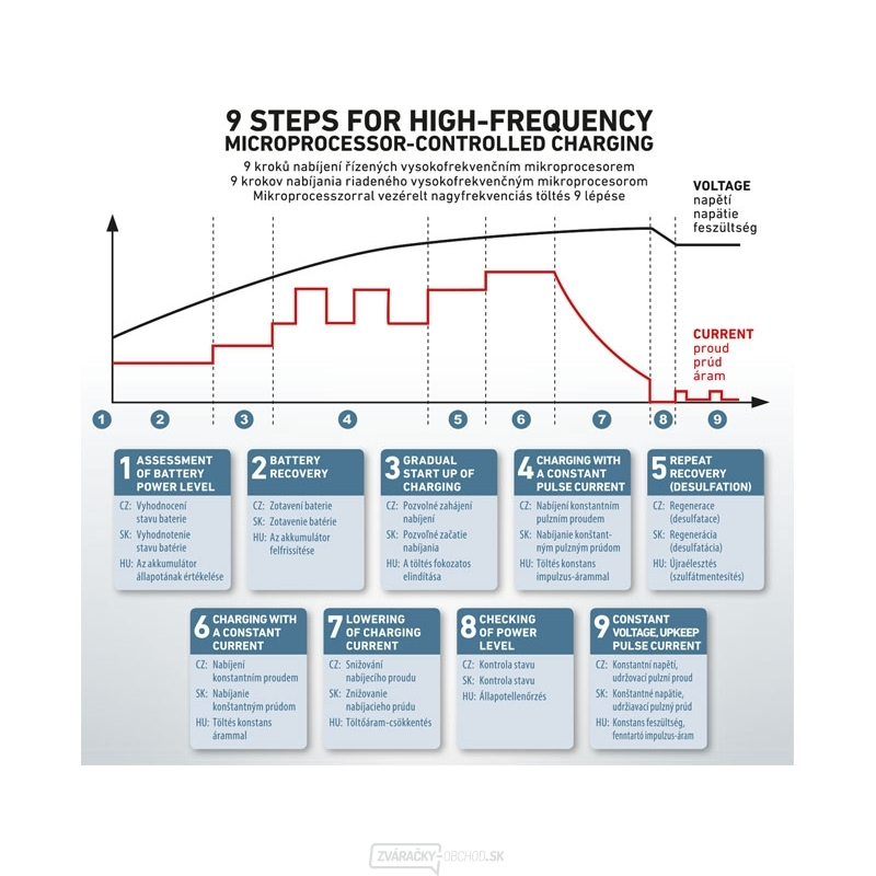

https://www.omegashop.sk/tovar/elektro/zasuvky/na-do/nabijacka-automoto-baterii-1224-v_1-6a_ip65-carclever-35939.html
https://www.zvaracky-obchod.sk/images/shop/products/34091/fullsize/wm-gallery-112.jpg
