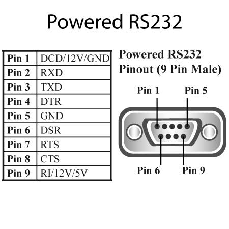

Co RS 232
http://www.brainboxes.com/files/catalog/product/PX /PX-823/img/PX-823_RS-232_Powered_Pinout.jpg
